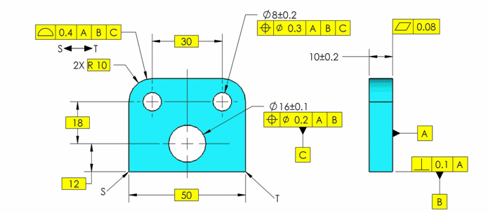

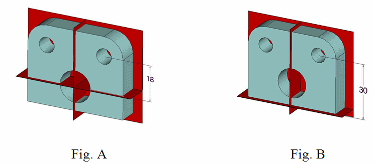

Here is a little test that one of our faithful readers asked me to create. He tells me that 9 out of 10 folks at his work get it wrong. Given the drawing, does figure A or B more correctly illustrate the datum reference framework which establishes an origin of measurement for the profile tolerance and the position callout on the two holes?
