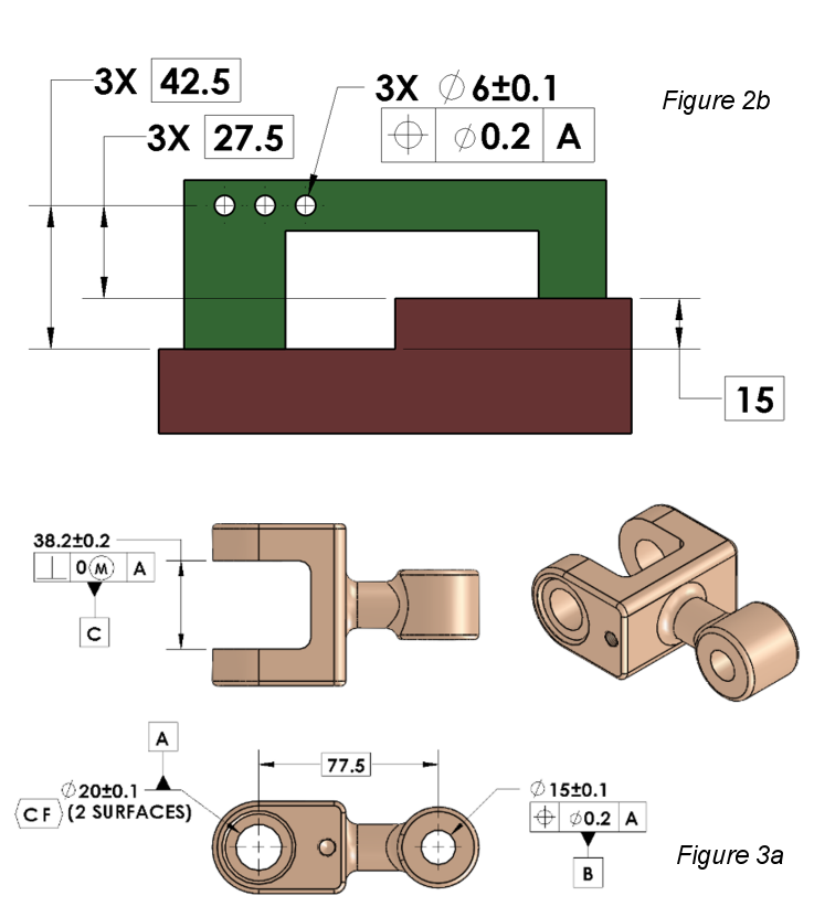

Datum plane A will be established on a datum feature simulator with a 15 mm offset between two planar surfaces, as shown in Figure 2b. Datum plane A, and also the origin of any basic dimensions that are normal to datum A, may be located at either of the two datum feature simulator surfaces.
In Figure 3a a pattern of two coaxial features of size is specified as datum feature A. One datum axis will be established by a cylindrical datum feature simulator that mates with both features. A Continuous Feature modifier applied to the size tolerance defines the pattern of two coaxial holes as a single feature per Y14.5-2009 paragraph 3.3.23, or Y14.5-2018 paragraph 3.10. Since Y14.5’s rule #1 imposes one perfect form boundary at the MMC size limit the size, the form and the coaxiality of the two holes are controlled by the size tolerance.
Figure 2b) Two offset, parallel, planar surfaces as a pattern with the datum feature mated with its datum feature simulator
Figure 3a) A pattern of two coaxial holes as datum feature A:

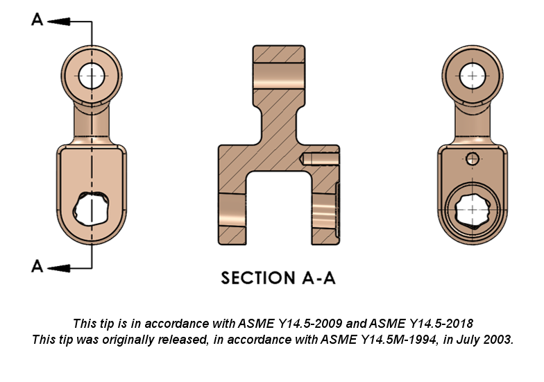

Since datum feature A is referenced at Regardless of Material Boundary (RMB), the datum feature simulator will the Unrelated Actual Mating Envelope (UAME) of the pattern of two holes. The UAME can be found by using a gage pin, or by measuring a sufficient number of points within the two holes, then fitting a maximum inscribed cylinder to the measured points. The axis of that cylinder is datum axis A. Figure 3b) shows the part with an imperfect datum feature A, the datum feature simulator (the UAME in this case), and datum axis A.

Figure 3b) The Datum Axis is Found with the Datum Feature Simulator:
