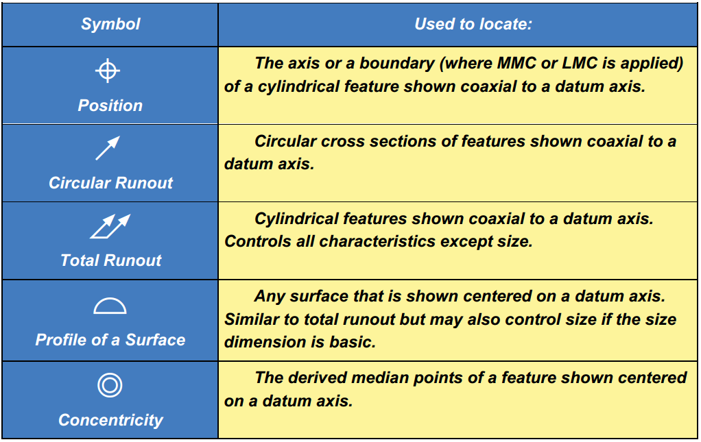

There are five ways to control coaxiality of features. They are:
With so many options it is no wonder that many people find the differences hard to understand. Each control has its place, although some are more difficult and time consuming than others. By comparing sample inspection methods, the differences may become clearer. This month’s tip will illustrate the differences between position and concentricity. Next month’s Tip will continue with the runout tolerances and profile.

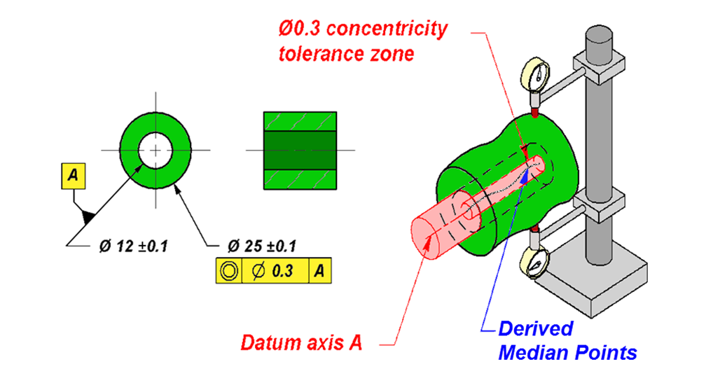

All of the coaxiality controls are intended to control concentric features. For that reason, many designers and engineers choose concentricity. Unfortunately, concentricity ignores the size, roundness and cylindricity of the feature. It requires that the inspector derive a median line (see the June 1997 Tip-of-the-Month). In a situation where you don’t care about the size, roundness or cylindricity of the feature, concentricity may be specified. In thirty plus years of reviewing mechanical designs, I have never found a design where this is truly the case. The closest application, perhaps, is when dynamic balance is needed. In such a case, measuring a part statically does not assure dynamic balance if the material is not homogeneous. If dynamic balance is required, a dynamic balancing note is probably in order rather than concentricity. For that reason, I often use the line, "When in Doubt, Use Runout."
