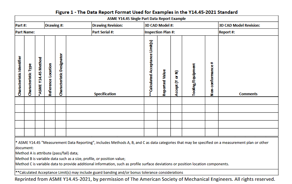

The AS9201B First Article Inspection form was used as the starting point for the report format used in Y14.45, with revisions made to better suit the needs of data to address GD&T specifications. Please review the columns provided in the data report format shown in Figure 1 before continuing.
The column titled “Characteristic Type” will hold a three-letter abbreviation or acronym to signify the type of tolerance. ASME Y14.45 provides a full list of those abbreviations, with examples including “MMC” for maximum material condition, “LMC” for least material condition (with both associated with size
The Characteristic Type information will also appear as part of the “Specification” column information, but the Specification column will have a GD&T font image of the tolerance or a longer string of characters. The Characteristic Type is meant to enable the conditional calculations which will vary based on the type of tolerance being reported.
The column titled “Characteristic Designator” provides the means to identify critical tolerances, sometimes called “Key characteristics”, or other types of tolerances such as “Process Control Tolerances”.

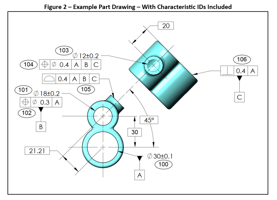

Characteristic IDs, sometimes called “Balloon numbers”, are included on our example drawing. They are best applied directly on the design drawing to ensure the same numbering is used in all geographic locations, but they can be applied later in the product development process, including manual marking on a hardcopy of the drawing by the metrology lab. Y14.45 does not mandate a particular way of applying characteristic IDs. Characteristic IDs are also included in the first column of our example data report, shown in Figure 1.
Y14.45 includes specific data content requirements for each type of tolerance specified, with each potential modifier applied, following the requirements in the GD&T standard, ASME Y14.5-2018. We have example data to illustrate some of the requirements and reporting tools provided in Y14.45. Before we review the example data, we need to describe the use of coordinate axes that represent a datum reference frame. They will be used to clarify feature location information when reporting method C data for position tolerances.

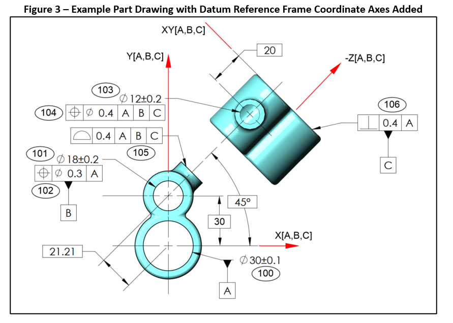

In ASME Y14.5-2009, a method called “Customized datum reference frames” was added that requires labeling of the X, Y, and Z coordinate axes of the datum reference frame(s). The Y14.45 standard requires these same X, Y, and Z coordinate axes if “Location components”, as method C data for position tolerances, will be required by the data customer. Location components are one or more X, Y, Z coordinate locations, for one or more locations on the controlled element of the feature. They provide a correct and conceptually valid method of reporting feature location information, to accompany the “Method B” reported position value. Measurement and reporting of basic dimensions may appear to be a way to provide feature location data, but this is prohibited by Y14.45 because basic dimensions are theoretically exact. Basic dimensions do their job of locating and orienting tolerance zones very well, but since they do not vary, they cannot be measured.
Print Reading for Today
Please note, in the figure above, the “XY[A,B,C]” label is applied to a line with no arrowhead in the auxiliary view. That view is not orthogonal to the front view of the part, so we are seeing projections of the X and Y axes in that view. We cannot label either of these axes, but using an extension of Y14.5 principles, we can label the XY plane of the datum reference frame. We leave the arrowhead off the line that represents the plane because planes do not have positive or negative directions. Please also notice that we included the list of datum features [A,B,C], used to establish our datum reference frame, on each axis label, even though we have only one datum reference frame for this part. This has the advantage of making it clear where these coordinate axes come from, but there is another reason we have done this, which will become clear in our next article about the Y14.45 standard, when we introduce “Reporting coordinate systems”. We will see in that next article, that the data for tolerance #104 on our example part can be reported more clearly with a reporting coordinate system implemented.

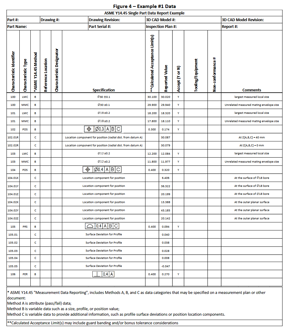

As shown in Figure 4, the data for position tolerances includes one or more location components as method C data, to provide feature location information. For the location components, the “.01” and “.02” items are data from two different locations, as described in the “Comments” cells. The data for profile tolerances includes “Surface deviations” as method C data, for at least a sample of the measured points, to provide feature location, orientation, form, and possibly size information. The “.01”, “.02”, etc. items for the surface deviations are for different points that were measured on the feature.
For the perpendicularity tolerance in our example, as with all form and orientation controls, Y14.45 specifies one reported method B value.
For size tolerances, two values are normally required by the Y14.45 standard. One value, as shown in our example above, is likely the diameter or width of the “Unrelated actual mating envelope” of the feature. The other value will then be the local size that addresses the place on the feature with the least material. Size tolerance reporting practices vary depending upon whether the size tolerance is imposing a perfect form boundary at maximum material condition or least material condition, per Y14.5s rule #1, or no perfect form boundary at all if rule #1 does not apply to the particular tolerance.
