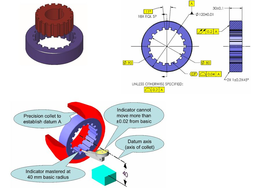

Last month’s Tip shows how using profile of a surface can increase allowable tolerance without affecting the function of a part. The original drawing used a size dimension and tolerance plus total runout to control the 18 teeth on the Cutter Ring. Making the size dimension basic and using profile of a surface allows both size and location to be inspected at the same time. The applied "CF" symbol creates a pattern of the 18 teeth.
Many people believe profile is difficult to measure. In this example, the profile tolerance is as easy to measure as a runout tolerance. The only difference between profile of a surface and total runout in this case is that the inspector must zero the indicator at the basic location from the simulated datum axis.
