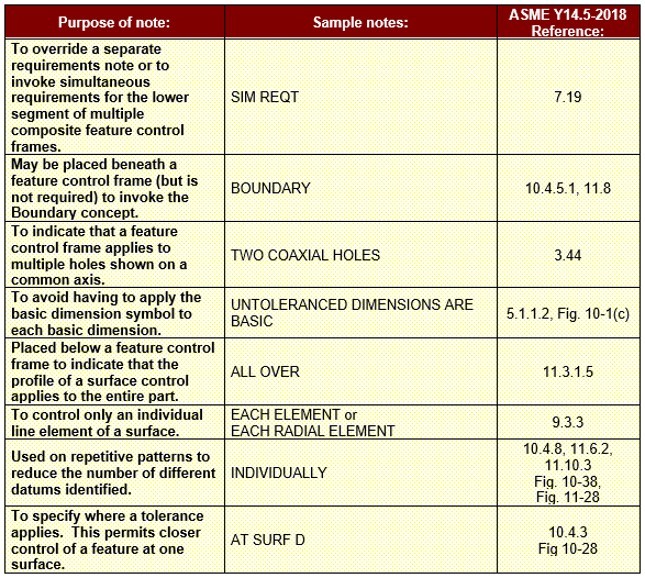

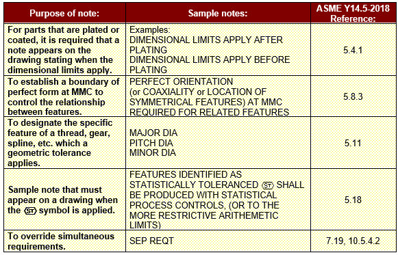

GD&T has greatly reduce the notes, in English, that are needed on the field of the drawing. There are still, however, a few notes that may be required to supplement GD&T. There have been requests to gather the notes found in ASME Y14.5-2018 to provide a quick reference. The following is a table of the notes found in the Standard along with a brief explanation of their purpose and a reference to where you can learn more about their use. You might want to keep this tip close by as a handy reference.
This tip is in accordance with ASME Y14.5-2018
